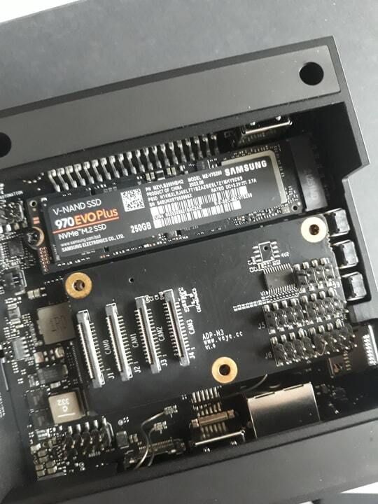

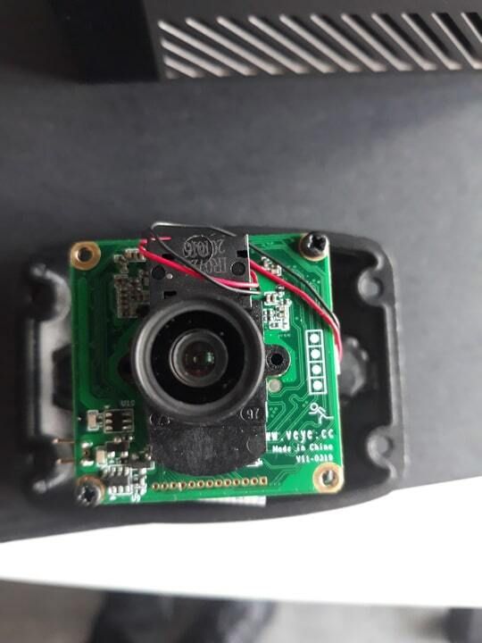

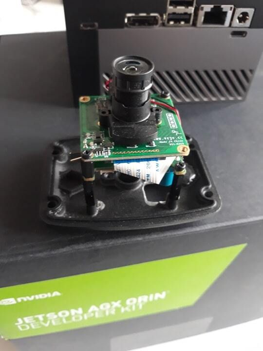

<?xml version="1.0" encoding="UTF-8"?><rss xmlns:dc="http://purl.org/dc/elements/1.1/" xmlns:content="http://purl.org/rss/1.0/modules/content/" xmlns:atom="http://www.w3.org/2005/Atom" version="2.0"><channel><title><![CDATA[NVIDIA Jetson Agx Orin 64Gb - IMX327s fpdlink camera software solution]]></title><description><![CDATA[<p dir="auto">Hello;</p>
<p dir="auto">We are using developer board (Agx Orin 64Gb version) and Jetpack 5.1.1 .<br />
I have a some questions? But I dont understand why .dtb file no included.</p>
<p dir="auto">I am including this path , this your solutions :<br />
<a href="https://wiki.veye.cc/index.php/VEYE_CS_Camera_for_Jetson_TX2" rel="nofollow ugc">link text</a>   (2.2 NVIDIA AGX Xavier(the same with Orin))  but we are using fpd link fakra connection with deserilizer. I am including 6 cameras in Jetson Agx Orin, Jetpack 5.1 but we dont see .dtb file Jetson Orin library .</p>
<p dir="auto">How to solve this problem . with fpdlink solution .<br />
<img src="/assets/uploads/files/1689165548684-20230712_140115_720-min.jpg" alt="20230712_140115_720-min.jpg" class=" img-fluid img-markdown" /> <img src="/assets/uploads/files/1689165548671-20230712_135937_720-min.jpg" alt="20230712_135937_720-min.jpg" class=" img-fluid img-markdown" /> <img src="/assets/uploads/files/1689165548653-20230712_140106_720-min.jpg" alt="20230712_140106_720-min.jpg" class=" img-fluid img-markdown" /></p>
