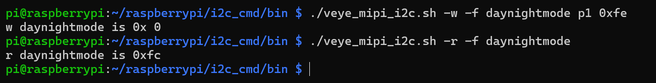

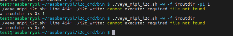

<?xml version="1.0" encoding="UTF-8"?><rss xmlns:dc="http://purl.org/dc/elements/1.1/" xmlns:content="http://purl.org/rss/1.0/modules/content/" xmlns:atom="http://www.w3.org/2005/Atom" version="2.0"><channel><title><![CDATA[IMX462在树莓派Bookworm系统上能正常使用qv4l2,但是无法切换日夜模式]]></title><description><![CDATA[<p dir="auto"><img src="/assets/uploads/files/1716453771547-4bfdef9d-baee-4a0d-8bdc-86273910f29d-image.png" alt="4bfdef9d-baee-4a0d-8bdc-86273910f29d-image.png" class=" img-fluid img-markdown" /><br />
<img src="/assets/uploads/files/1716453828599-955869e8-a4f1-4955-a695-c0eb46164e5e-image.png" alt="955869e8-a4f1-4955-a695-c0eb46164e5e-image.png" class=" img-fluid img-markdown" /><br />
文件都有加权限，且都在文件夹下，请问有什么办法能解决吗？非常感谢。</p>

]]></description><link>http://forum.veye.cc/post/4137</link><guid isPermaLink="true">http://forum.veye.cc/post/4137</guid><dc:creator><![CDATA[veye_xumm]]></dc:creator><pubDate>Thu, 30 May 2024 08:58:53 GMT</pubDate></item><item><title><![CDATA[Reply to IMX462在树莓派Bookworm系统上能正常使用qv4l2,但是无法切换日夜模式 on Thu, 30 May 2024 08:57:53 GMT]]></title><description><![CDATA[<p dir="auto"><a class="plugin-mentions-user plugin-mentions-a" href="/user/veye_xumm" aria-label="Profile: veye_xumm">@<bdi>veye_xumm</bdi></a> 你好，重新编译后指令不生效，还有什么需要注意的地方嘛<img src="/assets/uploads/files/1717059468139-4f8ca793-a20c-42a0-bb5f-e5022cf303f8.png" alt="4f8ca793-a20c-42a0-bb5f-e5022cf303f8.png" class=" img-fluid img-markdown" /></p>
]]></description><link>http://forum.veye.cc/post/4136</link><guid isPermaLink="true">http://forum.veye.cc/post/4136</guid><dc:creator><![CDATA[若兮鱼]]></dc:creator><pubDate>Thu, 30 May 2024 08:57:53 GMT</pubDate></item><item><title><![CDATA[Reply to IMX462在树莓派Bookworm系统上能正常使用qv4l2,但是无法切换日夜模式 on Fri, 24 May 2024 03:10:34 GMT]]></title><description><![CDATA[<p dir="auto"><a class="plugin-mentions-user plugin-mentions-a" href="/user/veye_xumm" aria-label="Profile: veye_xumm">@<bdi>veye_xumm</bdi></a> 非常感谢，我这边试下</p>
]]></description><link>http://forum.veye.cc/post/4106</link><guid isPermaLink="true">http://forum.veye.cc/post/4106</guid><dc:creator><![CDATA[若兮鱼]]></dc:creator><pubDate>Fri, 24 May 2024 03:10:34 GMT</pubDate></item><item><title><![CDATA[Reply to IMX462在树莓派Bookworm系统上能正常使用qv4l2,但是无法切换日夜模式 on Fri, 24 May 2024 01:14:52 GMT]]></title><description><![CDATA[<p dir="auto"><a class="plugin-mentions-user plugin-mentions-a" href="/user/%E8%8B%A5%E5%85%AE%E9%B1%BC" aria-label="Profile: 若兮鱼">@<bdi>若兮鱼</bdi></a> 提示i2c_write没有，如果此目录下有这个文件，可能是因为你的piOS是64位系统。你需要进入source目录重新编译一下i2c_read和i2c_write并拷贝到当前bin目录下。</p>
]]></description><link>http://forum.veye.cc/post/4105</link><guid isPermaLink="true">http://forum.veye.cc/post/4105</guid><dc:creator><![CDATA[veye_xumm]]></dc:creator><pubDate>Fri, 24 May 2024 01:14:52 GMT</pubDate></item></channel></rss>
