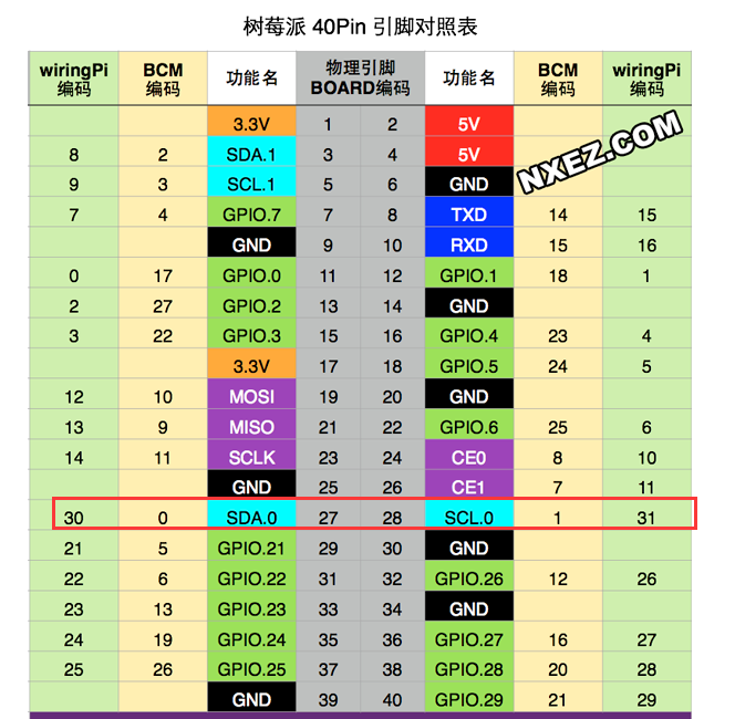

        By the way,
        I've been curious as to why your app causes the menu to appear, and since there is no dsi screen, on the two pins below, have you connected any other i2c sensor devices?
        D 1 Reply Last reply Reply Quote 0
        • D Offline
          Dan_LionKing @veye_xumm
          No devices are connected to these contacts. The camera is connected to RPi4b and RPiZero only via the CSI interface.
