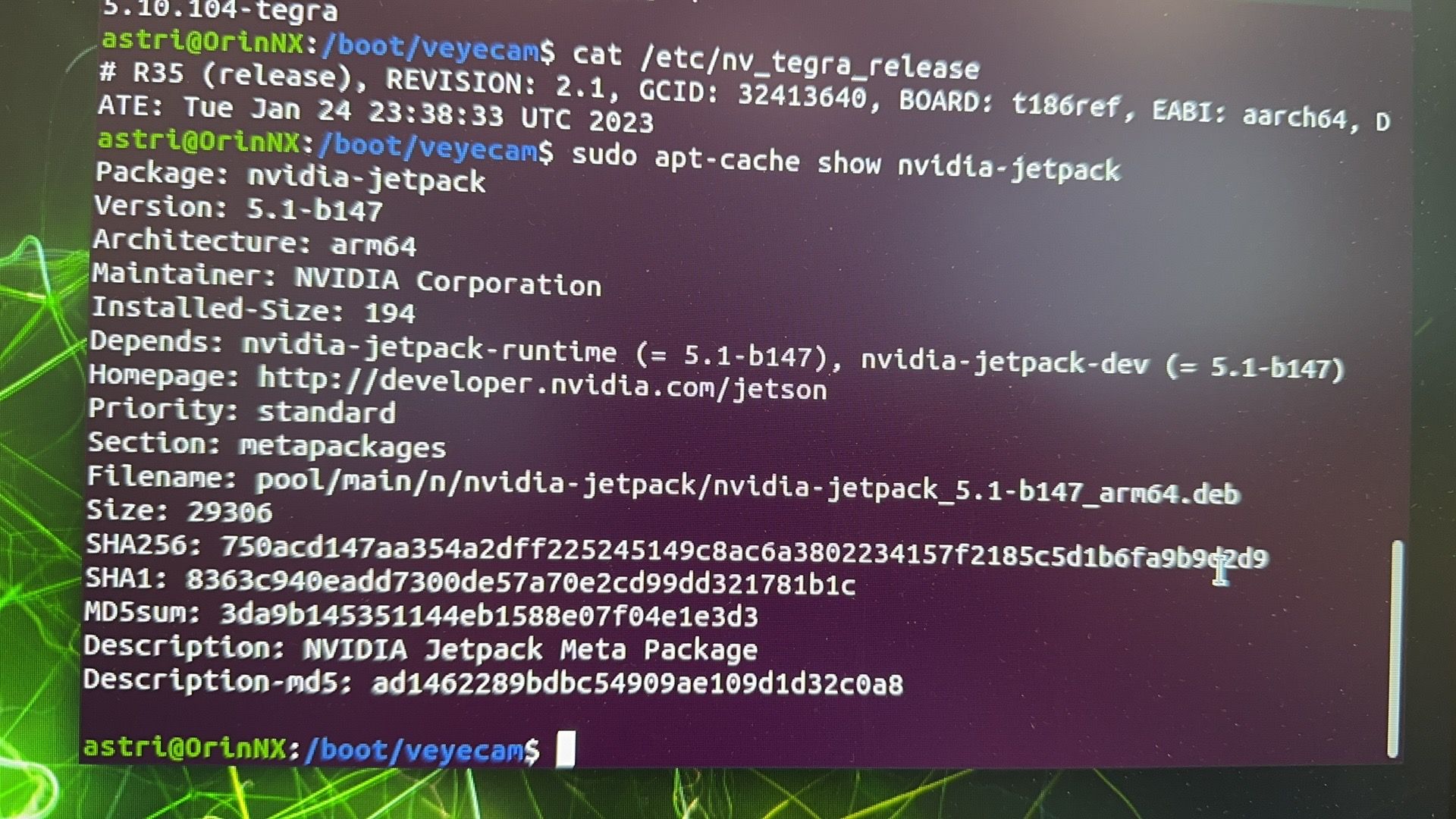

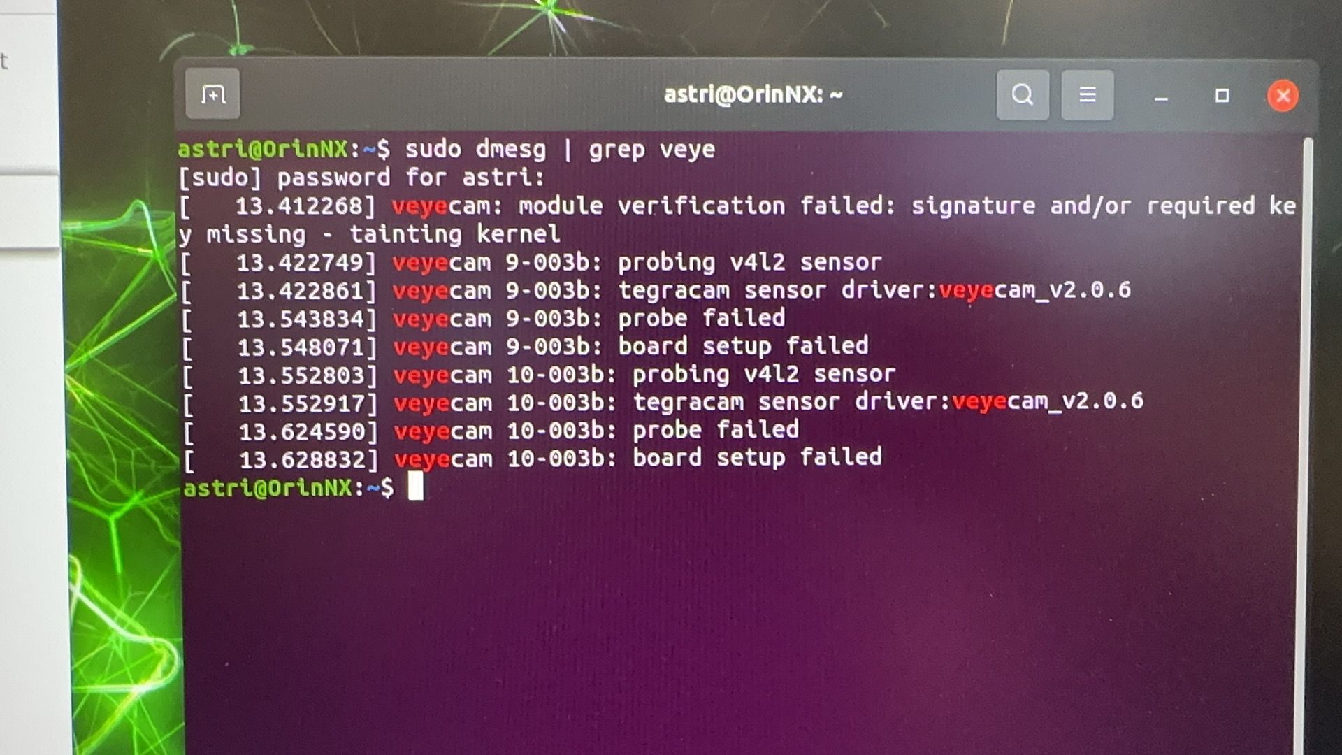

      Dear all, I purchase VeYe IM462 camera module and connect to Jetson Orin NX 8G (with carrier board J401 from seeed studio), I follow the wiki step etc but fail to get the driver work. I try the jetpack 5.1.1 with L4r35.3.1; Jetspack 5.1 with 35.2.1 also, but still fail to detect the camera. Can anyone have advise fImage5.jpeg or me ?Imag8.jpeg Image.jpeg

                    The current situation is that even i2cdetect cannot detect the VEYE camera properly, so I believe that adjusting the higher-level driver logic will not be useful.
