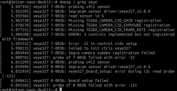

          I tried the driver you posted, but my system recognises the Serialiser device but not the camera, the dmesg messages are below. And My kernel driver is https://github.com/durmaz54/linux-tegra-4.9/tree/a1070cad347bae9ed667da759b00490a02b59083
          alt metni
            veye_xumm @samet_moveon
            @samet_moveon
            According to your previous hints, it seems that your FPD-Link channel has been successfully established, and Jetson can access the camera through I2C. However, there are several errors in your driver that need to be addressed.
