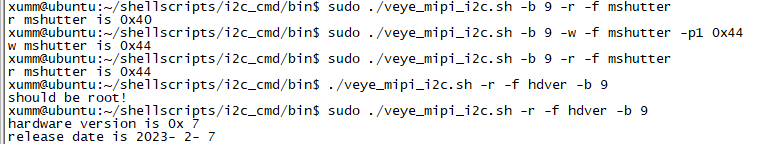

                    To confirm your I2C bus, please enter the following two commands and send the results back to me.
                    ./veye_mipi_i2c.sh -r -f hdver -b 9
                    ./veye_mipi_i2c.sh -r -f hdver -b 10
                    J 1 Reply Last reply Reply Quote 0

                            veye_xumm @joe last edited by
                            @joe Please try putting -b 10 at the end of the command.
                                @joe said in VEYE-imx462 and Orin Nano developer kit problem:
                                hardware version is 0x 7
                                From this point, your program reads hdver correctly.
                                However, based on the feedback from all your other scripts, it seems that both reading and writing cannot be executed properly.
                                Here are the commands and displays from my side. The difference is that the camera is connected to i2c-9.
                                How about you try recompiling i2c_read and i2c_write?
                                i2c_cmd/source/i2c_tools
