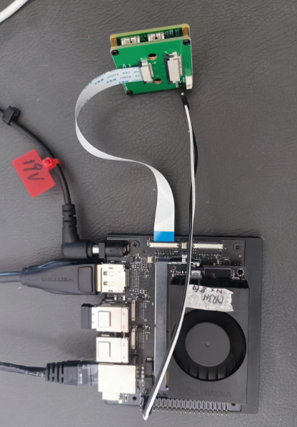

        I tested it, and the VEYE 327E works fine on both Orin Nano and Orin NX in my environment. Below is the connection diagram.
        The Jetpack version is 5.1.2, and the device tree binary (DTB) used is from the JetPack_5.1.2_Linux_JETSON_ORIN_TARGETS/dts/dtb/VEYE-MIPI-CAM2M directory.

        I recently received some feedback indicating issues with MIPI signal quality when using a non-official carrier board for Orin Nano/NX.
        I'd like to confirm, are you using NVIDIA's official development kit (devkit) or a third-party board?

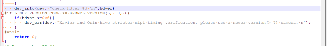

            使用Jetson Orin nano &MIPI 327E,jetson pack 5.1.2,但驅動回報如下,請問如何處理,感謝
            [ 107.875905] veyecam: module verification failed: signature and/or required key missing - tainting kernel
            [ 107.896881] veyecam 9-003b: camera id is veyecam
            [ 107.902269] veyecam 9-003b: sensor is IMX327
            [ 107.906698] veyecam 9-003b: board type is TWO board
            [ 107.911907] veyecam 9-003b: Xavier and Orin have stricter mipi timing verification, please use a newer version(>=7) camera.
            [ 107.937255] veyecam 10-003b: probe failed
            [ 107.941498] veyecam 10-003b: board setup failed

              你可以先忽略这个提示,直接按照wiki文档的说明,继续测试一下取图等功能。

                @veye_xumm 動態連結.ko,這個訊息是驅動主動發的,之後就退掉了,無法再向下測測

                  这个只是一个提示信息,不影响驱动加载和后续测试的。
                  你可以看看有没有生成/dev/video0,如果没有,看看dtb是不是用对了。
