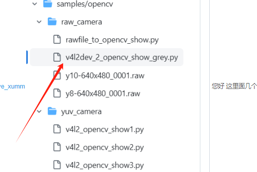

                                          hxm @veye_xumm last edited by
                                          @veye_xumm b40957ff-5070-4cff-a777-b9b93c034495-88c7c574b5da2df01a26ee93c7b6ebd.png 您好 这里面几个的代码那个适合MV-MIPI-SC130M显示并采集视频流呢 谢谢
                                            veye_xumm @hxm last edited by
