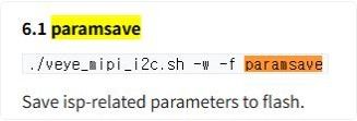

      I would like to use the Paramsave command to store the modified parameters.
      After saving, I want the device to operate with the updated parameters after reboot.

        veye_xumm @Deepcamera last edited by
        @deepcamera
        Only ISP-related parameters can be persistently saved after power-off through the paramsave command. Therefore, I recommend that you reconfigure your desired parameters in the startup script during program design.
        As for which commands can be saved, you can refer to the veye_mipi_i2c.sh source code. If the corresponding read/write functions contain operations like './i2c_write $I2C_DEV $I2C_ADDR 0x10 0xDA', it indicates that the function's register belongs to the ISP category and can be saved using paramsave.
