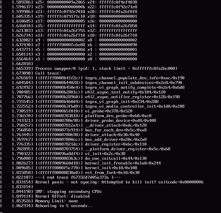

    It went into a boot loop. [JP 4.4.1, Nano B01, IMX307]
    6 Posts 2 Posters 2.4k Views 1 Watching
    • O Offline
      octa_yk
      Hi
      I applied the CS-MIPI-IMX307 dtb file on my Jetson Nano B01.
      When I rebooted the OS, it went into a boot loop.
      Does this not happen in your environment?
      Here is the detailed information.

        veye_xumm @octa_yk
        @octa_yk
        Hi, sorry for that. I think it's a dtb bug by us. You can use jetpack 4.5 version by now.
        And we will fix that bug today. Please look at the github later.
          veye_xumm @octa_yk
          @octa_yk
          Hi,
          The bug has been fixed, please check the github.
