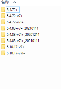

      • veye_xummV Online
        veye_xumm @esjeeybi
        @esjeeybi
        We do not provide the corresponding version of your piOS release file for the time being. You can try to compile the driver from the source code, or upgrade your piOS.

        • E Offline
          esjeeybi @veye_xumm
          Hi, I have updated and still no file. Unfortunately, I can't compile.
          install: cannot stat './driver_bin/5.10.52-v7l+/cssc132.ko': No such file or directory
          install: cannot stat './driver_bin/5.10.52-v7l+/cssc132.dtbo': No such file or directory
          • veye_xummV Online
            veye_xumm @esjeeybi
            @esjeeybi
            OK, I will try compile this version for you.
            • veye_xummV Online
              veye_xumm @esjeeybi
              @esjeeybi
              Done, please check github.

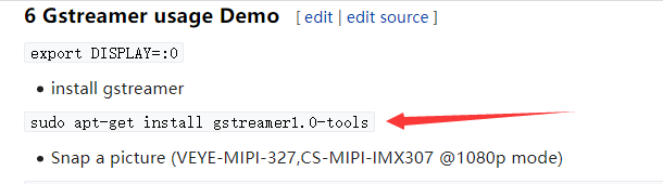

                pi@raspberrypi:~ $ export DISPLAY=:0
                pi@raspberrypi:~ $ gst-launch-1.0 v4l2src device=/dev/video0 ! "video/x-raw,format=(string)UYVY, width=(int)1280, height=(int)1080,framerate=(fraction)45/1" ! videoconvert ! autovideosink sync=false -v
                bash: gst-launch-1.0: command not found
                • veye_xummV Online
                  veye_xumm @esjeeybi
                  @esjeeybi
                  http://wiki.veye.cc/index.php/V4L2_mode_for_Raspberry_Pi#Gstreamer_usage_Demo
