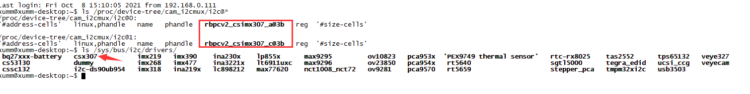

      I didn't work! After reboot, ls /sys/bus/i2c/drivers/ does not show the new driver and ls /proc/device-tree/cam_i2cmux/i2c@* does not show the camera model.

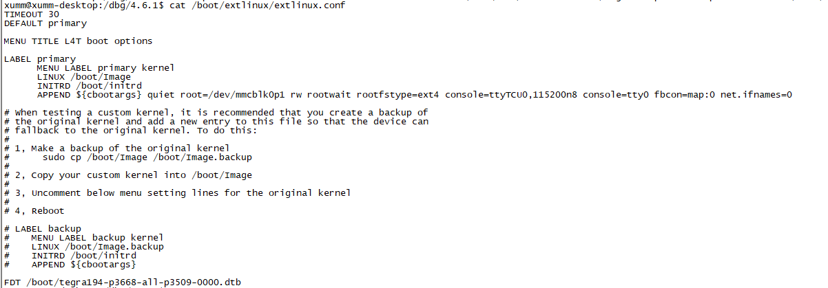

          Please write the following line to the end of the file.
          FDT /boot/tegra194-p3668-all-p3509-0000.dtb

            • veye_xummV Online
              veye_xumm @techies
              @techies
              Sorry reply finished. China took a 7 day holiday. We just got back to work.
              There is no tab in front of FDT.
