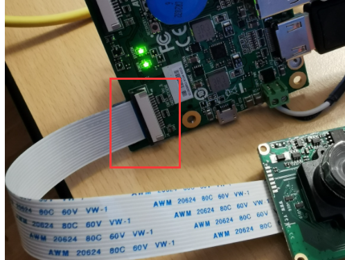

              veye_xumm @jetsonnano last edited by
              @jetsonnano said in CS132 Mipi csi global shutter camera not working on jetson Nano:
              cssc132
              please take a photo of your FFC cable connection and post here. I think may be the direction is wrong.
                [photo](file:///home/philippe/pCloudDrive/projet_drones/multimedia/2021/novembre/IMG_20211129_103747.jpg)
                J 1 Reply Last reply Reply Quote 0
                • J
                  jetsonnano @jetsonnano last edited by
                  https://e1.pcloud.link/publink/show?code=XZqglJZzVIX8mPQCgRtRLz3wH7Cnf61lPNX
                  https://e1.pcloud.link/publink/show?code=XZ6glJZD5yEGWmd3B5QBr5odRlsVJAE9ggk
                    @jetsonnano
                    You need to check the manual of this base board, to confirm the wire sequence of this connector, and the wire sequence of our module, whether it is correct.
                    http://wiki.veye.cc/index.php/CS-MIPI-SC132_Data_Sheet#Interface_.26_Pin_list

                      @veye_xumm we use this carrier board
                      we use the J4 connector, please check https://storage.avermedia.com/web_release_www/EN715/AVerAI_UM_EN715_VB_CB_BPC_20210519_.pdf
                      the pinout is the same as per your documentation
                        @jetsonnano
                        I don't think you have a problem with the wiring.
                        But avermedia base board, will it work with nvidia nano b01 dts? That is, do they have the same hardware design?
                        I think you'd better check with avermedia first if avermdia base board is consistent with the official development board in terms of camera interface and i2c design.
                        Usually you need to do a driver migration.
