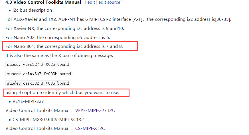

      I have two cameras (SC132) used in Nano B01, and I want to set them to hardware-triggered mode. I wonder how can I do this using I2C command. It seems that I2C command does not specify a camera device.

        Please refer to here:
        http://wiki.veye.cc/index.php/VEYE_CS_Camera_for_Jetson_TX2#Video_Control_Toolkits_Manual
