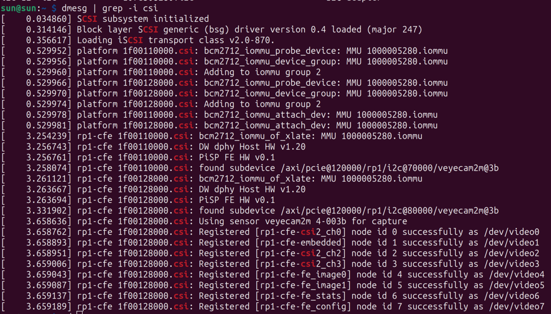

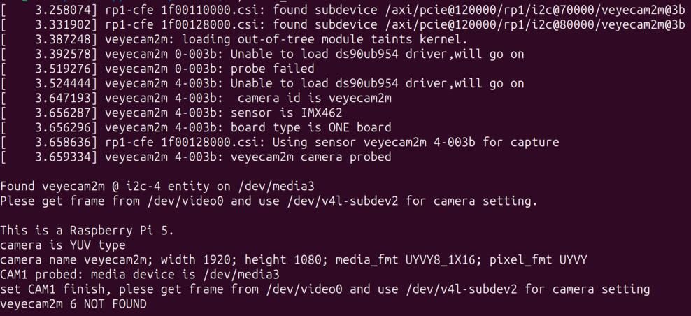

      你好,我在使用两个imx-642相机,
      用 https://wiki.veye.cc/index.php/V4L2_mode_for_Raspberry_Pi 安装了驱动。
      用树莓派5 CAM1可以打开并设置相机,但是CAM0口找不到相机。
      尝试更换了相机,单独插在CAM0口上还是识别不了。

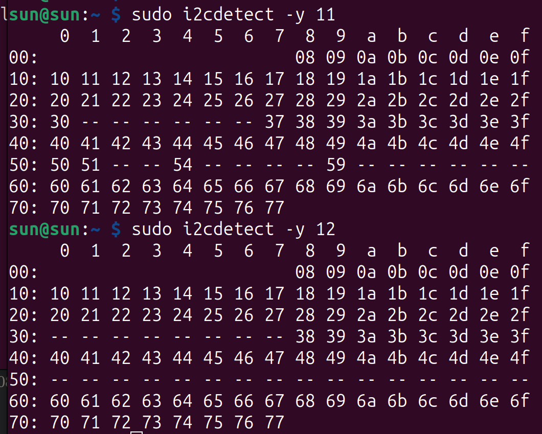

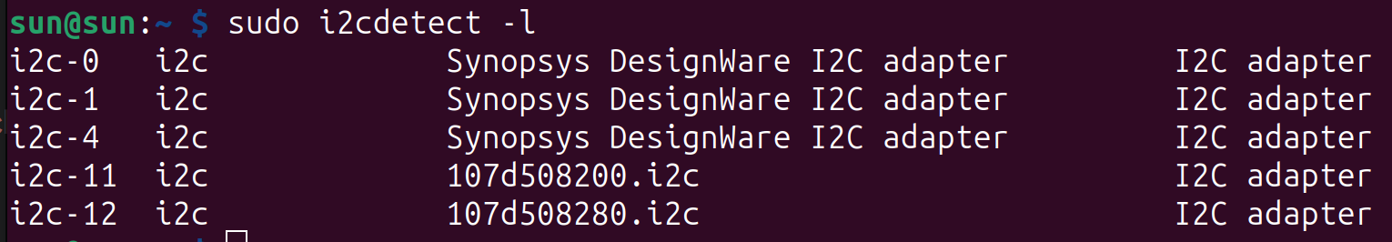

      mipi接口是i2c-11和i2c-12吗?这两个接口好像是正常的。
      e368e99b-7f09-47b3-9a05-77d413515cfa-Screenshot from 2024-06-08 10-14-06.png
      这个情况是接口坏了还是漏了什么东西没有设置?

        Correct camera location should be:
        /axi/pcie@120000/rp1/i2c@88000/veyecam2m@3b
        /axi/pcie@120000/rp1/i2c@80000/veyecam2m@3b
        As I see your second camera on ic2@70000 similar as I had with wrong overlay file.

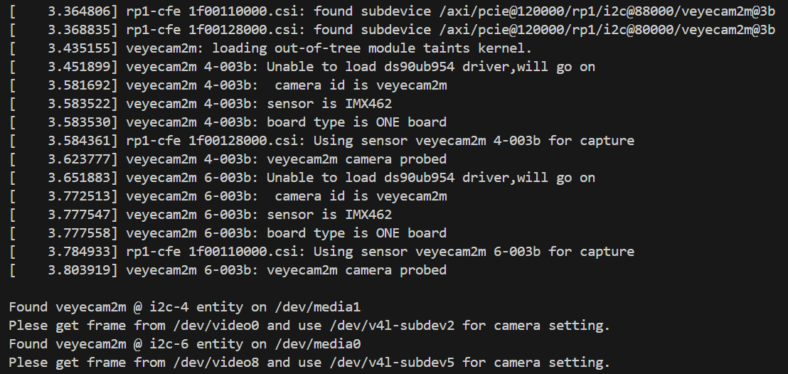

          I used the script from the release folder to install the driver, and the operating system version is 6.6.20-1+rpt1.
          So, while installing the driver, I think the DTS file used by the script is raspberrypi_v4l2/driver_source/dts/rpi-6.6.y/veyecam2m-overlay.dts, which already has cam0 = <&i2c_frag>, "target:0=",<&i2c_csi_dsi0>.
          I compiled the source code, and now both cameras are recognized!
            veye_xumm @sqf121 last edited by
