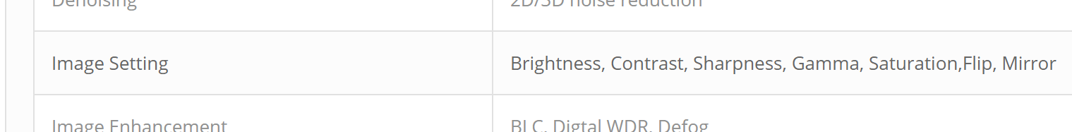

      as mentioned in the spec data docs on the veye website, i expected to find the possibility to set settings for brightness, sharpness, and gamma. See snip below from website:
      With the i2c toolset i could find these settings.
      How can I adjust the brightness and gamma on the cs-mipi-imx307?
      Thx in advance.
