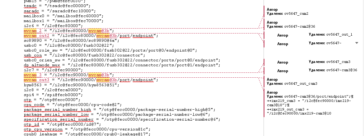

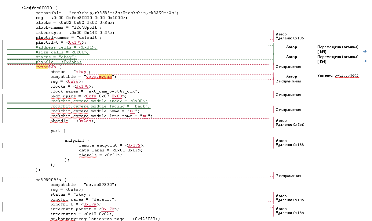

      @veye_xumm hi. i`m trying to build Kernel itself left alone the full image.
      and see this error in compile the veye driver:
      so the problem in driver file - [0_1772540181473_veyecam2m.zip](Загрузка 100%)
      posted in Rockchip App camera
      zoldaten
      zoldaten
    • RE: OrangePi cm5-tablet RAW-MIPI-SC132M
      @veye_xumm veye appears only on image you provided via download link.
      the image i built has no veye on board.
      should i change the main dts after decompilation ...tablet.dbt > ...tablet.dts?
      or use somehow dtsi (https://github.com/veyeimaging/rk35xx_orangepi/tree/main/linux/drivers/cm5/cm5-mvcam-dts) to link with your ...tablet.dbt ?
      zoldaten

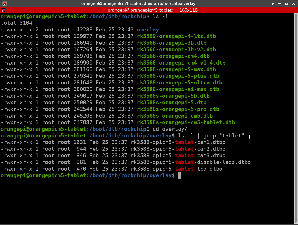

      @veye_xumm and i do not see any overlays from here compiled on image
      2026-02-26_11h44_43.png :
