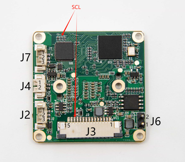

            veye_xumm @oleg last edited by
            @oleg
            This link provides a reference for workarounds to this problem.
            Camera menu appears on VEYE-MIPI-IMX327S
            However, I'm curious why this issue occurs so frequently on your end. Could you please measure the SCL level using an oscilloscope? When the VEYE module is not configured, SCL should always remain high. If there are frequent and continuous level changes, it indicates that the system is operating on the I2C bus.
