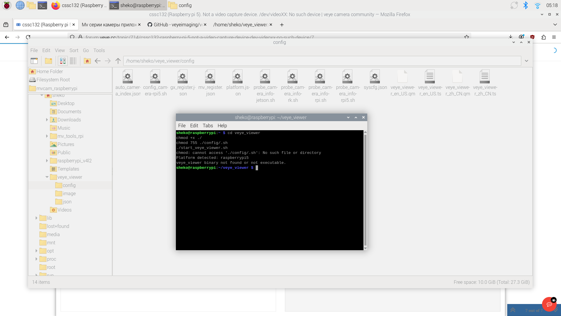

      Hello. I'm having trouble getting my RAW-MIPI-SC132M camera to work. The driver installed without errors. What am I doing wrong?
      sheko@raspberrypi:~ $ uname -r
      6.12.47+rpt-rpi-2712
      sheko@raspberrypi:~ $ v4l2-ctl --list-formats-ext
      Cannot open device /dev/video0, exiting.
      sheko@raspberrypi:~ $ camera id is cs-mipi-sc132
      bash: camera: command not found
      sheko@raspberrypi:~ $ dmesg | grep -i video
      [ 3.029552] videodev: Linux video capture interface: v2.00
      [ 3.127255] rpi-hevc-dec 1000800000.codec: Device registered as /dev/video19
      sheko@raspberrypi:~ $ sudo ffmpeg -f v4l2 -i /dev/video19 output.mp4

      [video4linux2,v4l2 @ 0x55561c74ad30] Not a video capture device.
      /dev/video19: No such device

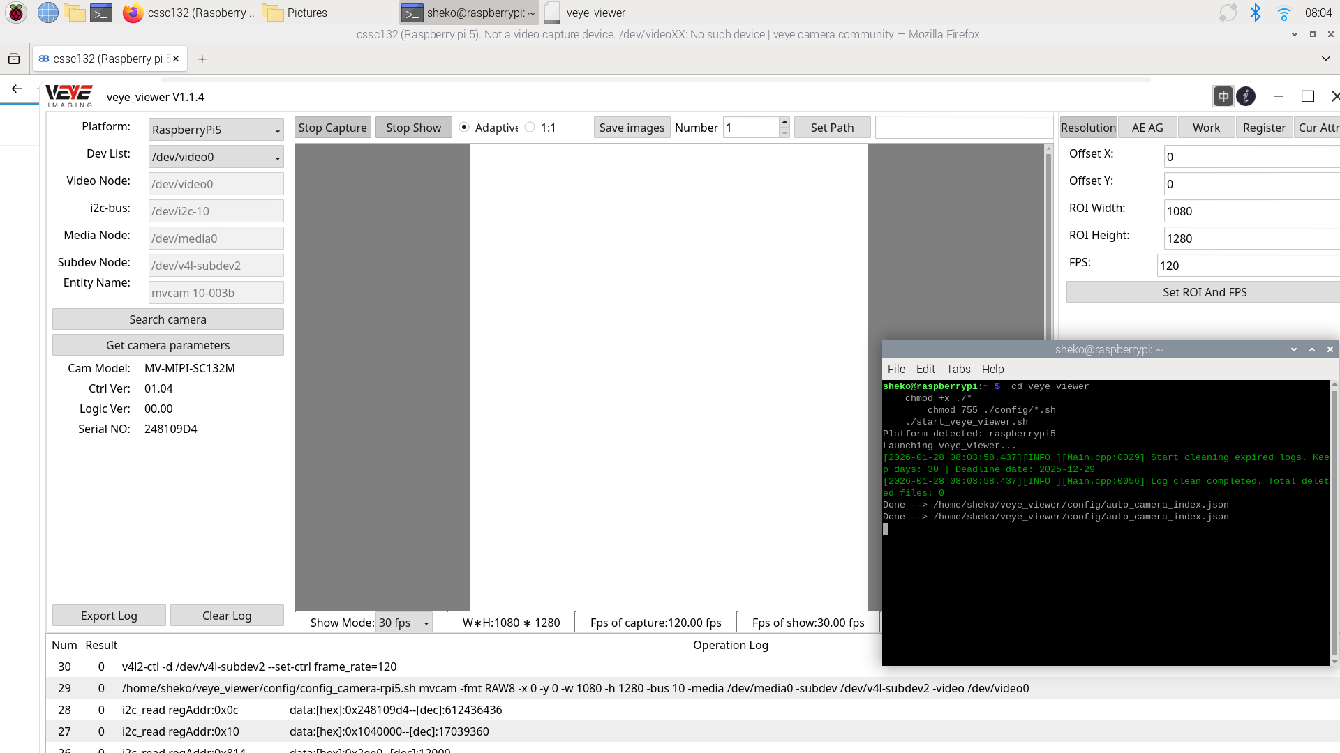

      [ 3.091990] rp1-cfe 1f00110000.csi: found subdevice /axi/pcie@1000120000/rp1/i2c@88000/cssc132@3b
      [ 3.092673] rp1-cfe 1f00128000.csi: found subdevice /axi/pcie@1000120000/rp1/i2c@80000/cssc132@3b
      [ 3.127041] cssc132: loading out-of-tree module taints kernel.
      [ 3.127068] cssc132: disagrees about version of symbol v4l2_i2c_subdev_init
      [ 3.127070] cssc132: Unknown symbol v4l2_i2c_subdev_init (err -22)

                    @veye_xumm './config/.sh': No such file or directory
                    what am I doing wrong?
                    sheko@raspberrypi:~ $ cd veye_viewer
                    chmod +x ./
                    chmod 755 ./config/.sh
                    ./start_veye_viewer.sh
                    chmod: cannot access './config/.sh': No such file or directory
                    Platform detected: raspberrypi5
                    veye_viewer binary not found or not executable.
                      veye_xumm @Sheko last edited by

                      Hi,
                      It looks like you downloaded the source code, but didn’t compile it. You can download the precompiled binary from the link below and run it directly.
                      https://github.com/veyeimaging/veye_viewer/releases/download/v1.1.4_rpi/veye_viewer_RaspberryPi_bin.zip
                      S 1 Reply Last reply Reply Quote 0

                        Sheko @veye_xumm last edited by
                        Hi,
                        here is the result^
                        heko@raspberrypi:~/veye_viewer_RaspberryPi_bin $ ./start_veye_viewer.sh
                        bash: ./start_veye_viewer.sh: Permission denied
                        sheko@raspberrypi:~/veye_viewer_RaspberryPi_bin $ chmod 755 ./config/.sh
                          @sheko
                           cd veye_viewer
                              chmod +x ./*
                          	chmod 755 ./config/*.sh
                          • S
                            the program started
                            white screen - no image
                            chmod +x ./*
                            Launching veye_viewer...
                            [2026-01-28 07:59:42.882][INFO ][Main.cpp:0029] Start cleaning expired logs. Keep days: 30 | Deadline date: 2025-12-29
                            [2026-01-28 07:59:42.886][INFO ][Main.cpp:0056] Log clean completed. Total deleted files: 0
                            Done --> /home/sheko/veye_viewer/config/auto_camera_index.json
                            (veye_viewer:2119): GLib-GObject-CRITICAL **: 07:59:44.547: g_object_unref: assertion 'G_IS_OBJECT (object)' failed
                            [2026-01-28 08:00:53.233][WARN ][unknown_file:----] libpng warning: iCCP: known incorrect sRGB profile
                            [2026-01-28 08:00:53.234][WARN ][unknown_file:----] libpng warning: iCCP: known incorrect sRGB profile
                            [2026-01-28 08:00:53.235][WARN ][unknown_file:----] libpng warning: iCCP: known incorrect sRGB profile
                              @sheko It looks like nothing is abnormal. You haven’t installed a lens, right?
