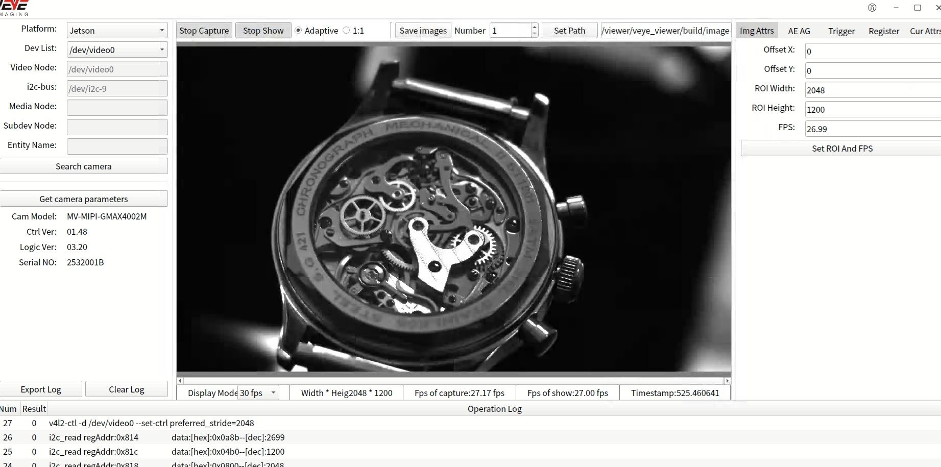

      @veye_xumm Good news, it's working!
      I changed the port to "CAM1" (i2c-9).
      I believe the "v0.1.1_jetson" files were essential for proper operation.
      Thank you for your efforts in helping.

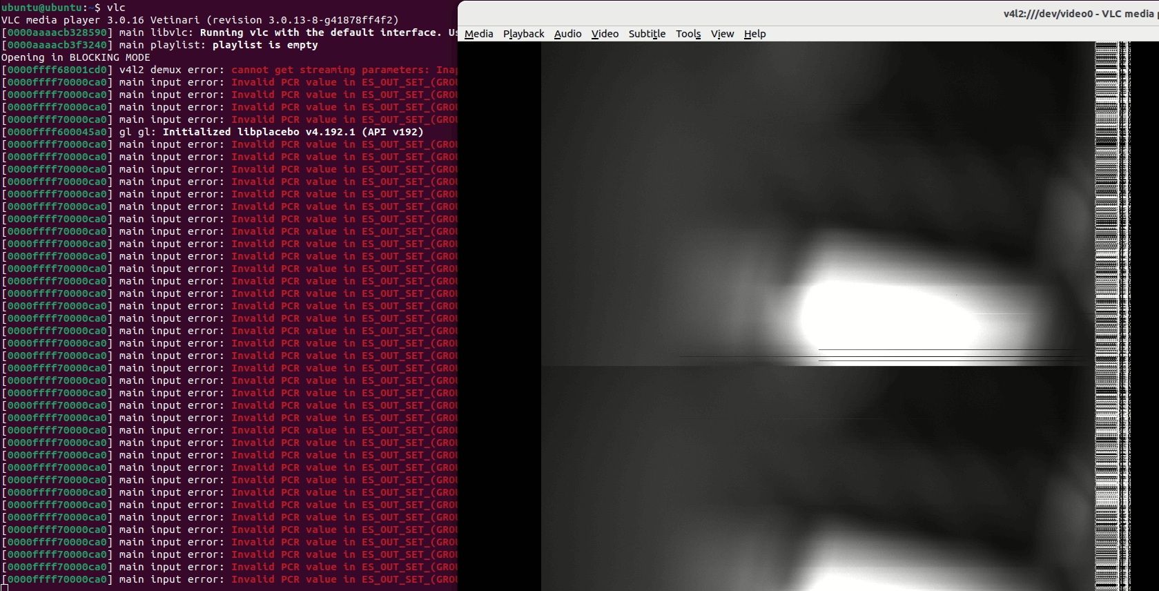

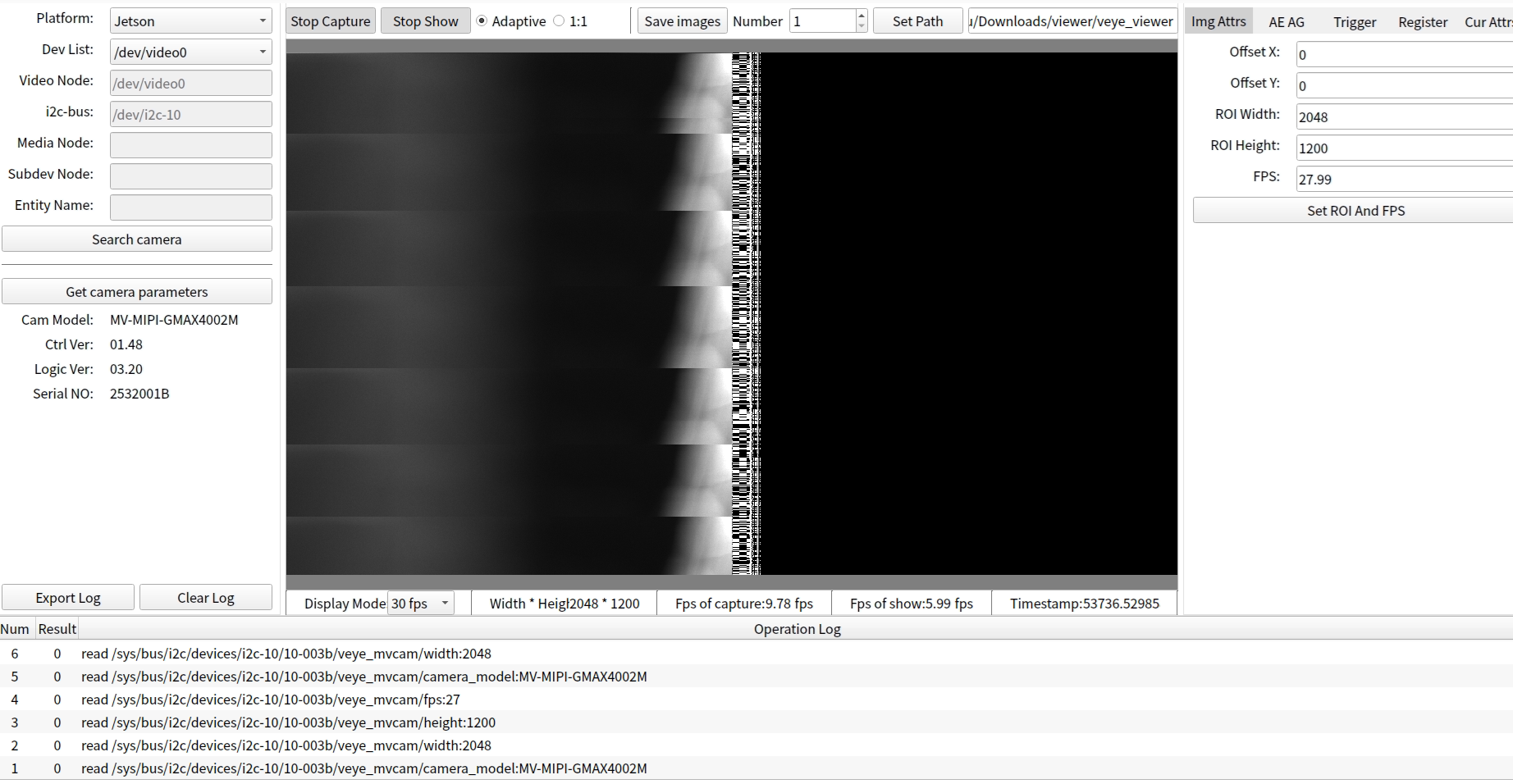

      Thank you very much for the reply, it really helped! I followed the recommendations faithfully and successfully completed the installation. However, I'm facing a problem:
      The camera generates an image with errors and very low fps, as shown in the attached image:
      Attached is the sudo dmesg: ubuntu@ubuntu~$ sudo dmesg.txt
      ubuntu@ubuntu:~$ sudo dmesg | grep -i 'fail'
