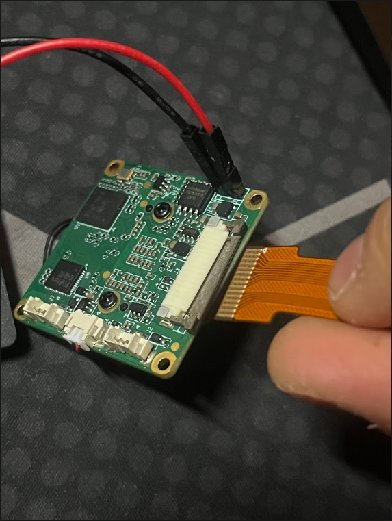

      In short, I have a Jetson Orin Nano and a IMX462, despite the way I orientate the camera cable, my Orin Nano can not detect the IMX462 despite having the drivers properly installed

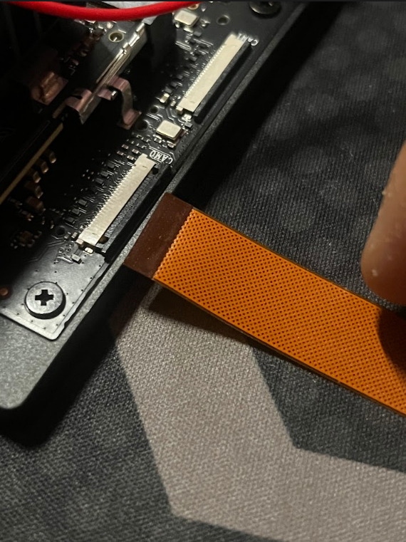

      As a sanity check, I've double/triple checked the orientation of the camera cables to my Jetson, the camera pins to the board are facing DOWN, while to the IMX462 the pins are facing UP

        1. I think your hardware connections are correct. Also, the Dupont wires are generally not required.

              • Re-flashed my Orin with the NVIDIA SDK manager
              • Changed the CSI cable with the second cable that was provided by you guys. I also ensured the black tab on the Jetson Orin was facing 'up' while the pins on the wider end of the CSI cable that went to the IMX462 was facing 'towards' the tab (Please see pictures below for reference)
              • And below are the steps that I took that eventually lead to the same probing error that was mentioned earlier
