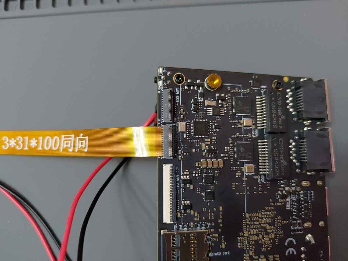

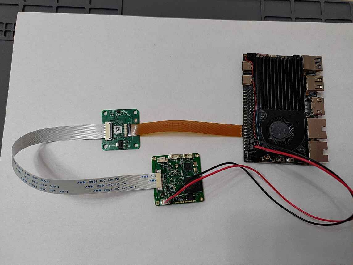

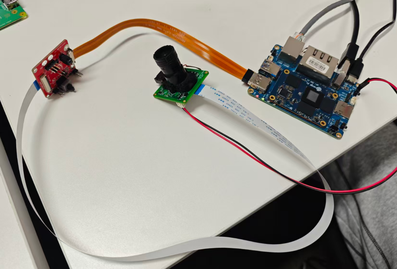

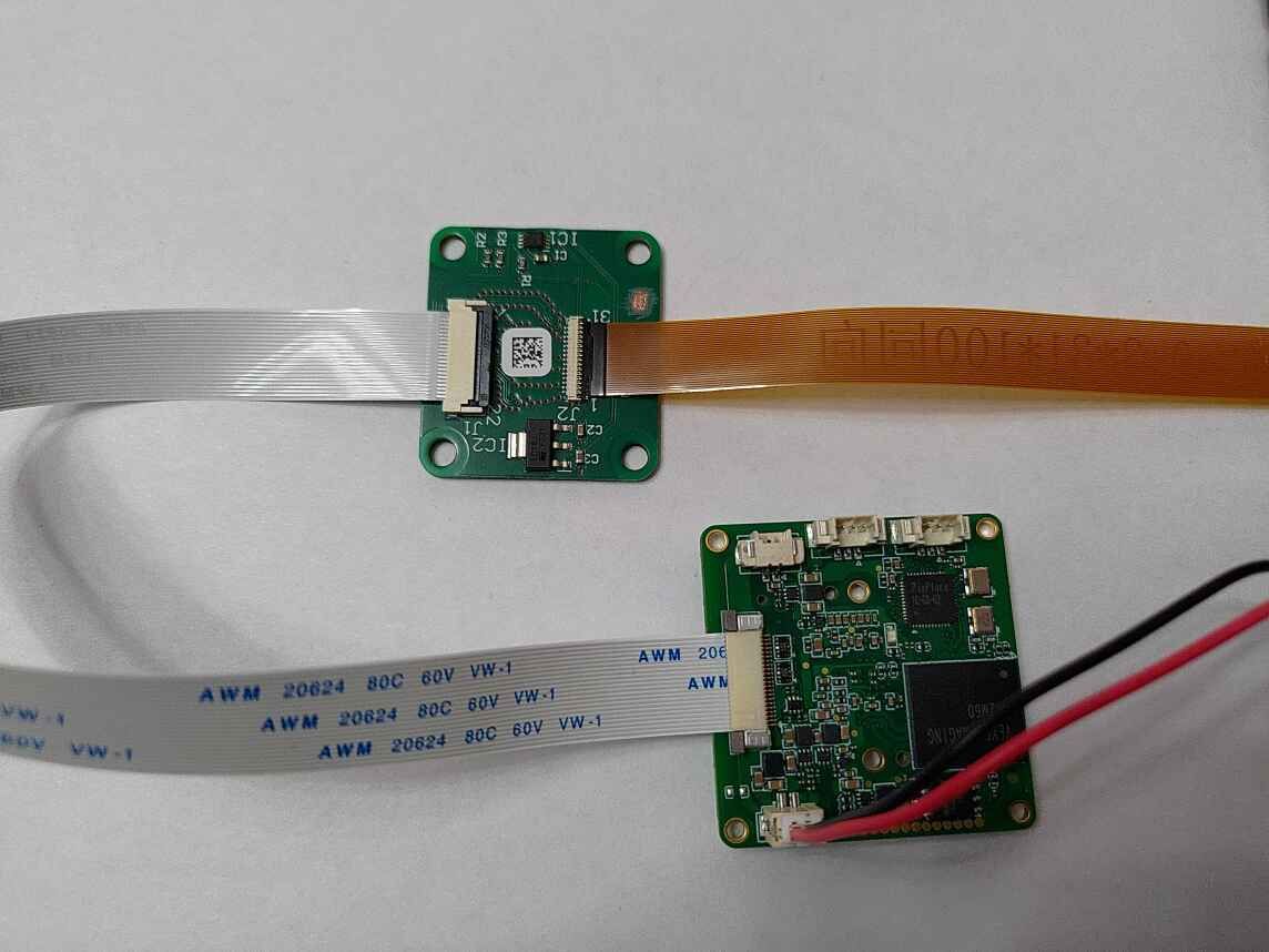

      However, I've encountered a problem during testing. My board has two identical 31-pin 0.3mm CSI connectors: CSI0 and CSI1. When a GX camera is connected to CSI0, the video stream fails to start and the kernel log is spammed with MIPI_CSI2 ERR1/ERR2 errors. The camera is correctly detected via I2C judging by correct output of gx_probe.sh. When connected to CSI1, frames are received at the expected 60 FPS, but the kernel log still has some errors (though much fewer).
      Some additional context:
      The cameras are always connected via the same adapter pcb (camera 22-pin to board 31-pin, 4-lane MIPI-CSI) that handles pinout and i2c levels. The adapter has a hardware limitation and both gpio pins (5 and 6) on camera side are pulled high (3.3V).
      The VEYE series cameras work without any issues on CSI0 using the same adapter and 15-pin to 22-pin stock cable. The GX cameras have external 5VDC connected (5.05V measured while running the test command) using stock dupont wires.
      I have tried updating the GX camera firmware but found it was already at the latest version referenced in the GX camera firmware update manual on wiki. I've also tried replacing the GX camera module with another one (I have two of them).

              Sure, here is my setup.
              The dev board is https://docs.armsom.org/armsom-sige7.
                veye_xumm @xLWvU7mX last edited by
                @xlwvu7mx
                I don't think it's a cable length issue or a DTS problem. Have you tried testing with a different adapter board or a different mainboard? I tested it with an Orange Pi CM5, using a 50cm FFC cable plus a 20cm FPC cable, and the image was very stable.
                X 1 Reply Last reply Reply Quote 0
