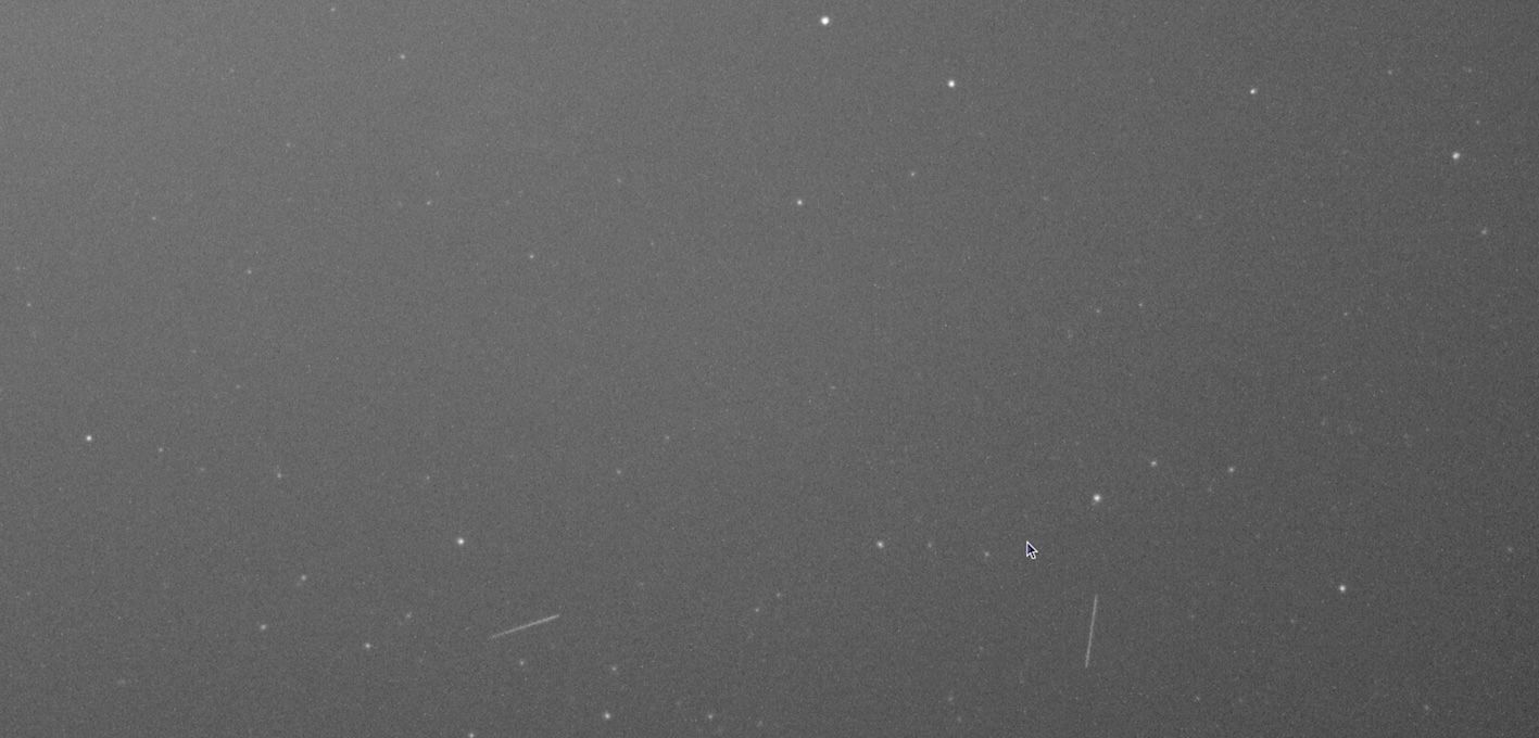

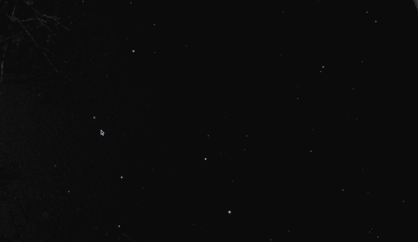

        Example of image in same time and same parameters (gain 34) for:
        GX IMX662
        VEYE IMX462

            • A Offline
              alex_ai @veye_xumm
              Hi @veye_xumm,
              Thank you for new update and letting me know!
              On first look - the original issue was fixed - now I can save fps parameter and we could close this topic.
              About night sky image, I don't see visible differences and want to play with parameters one more time and monitor camera registers.

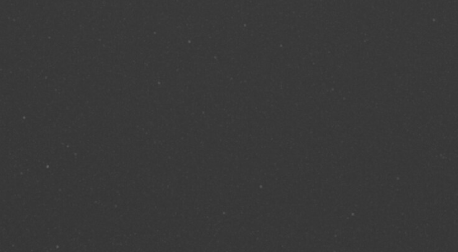

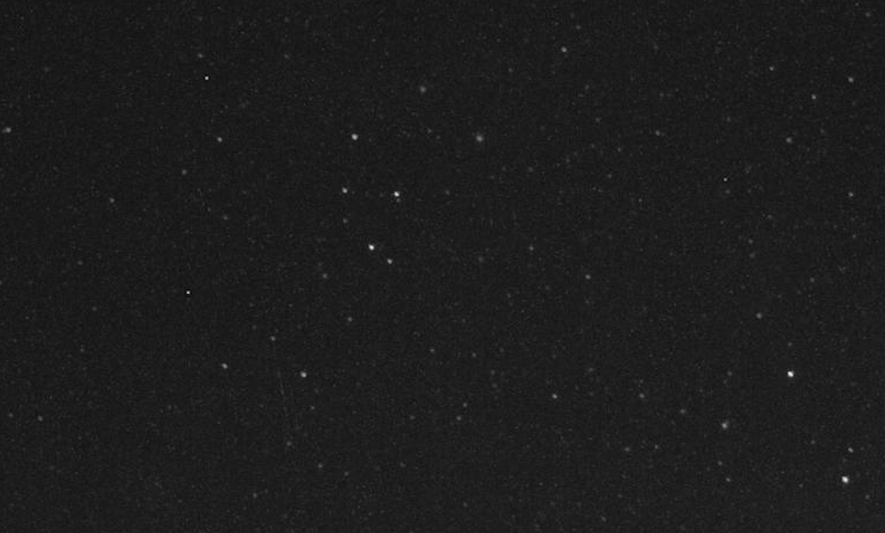

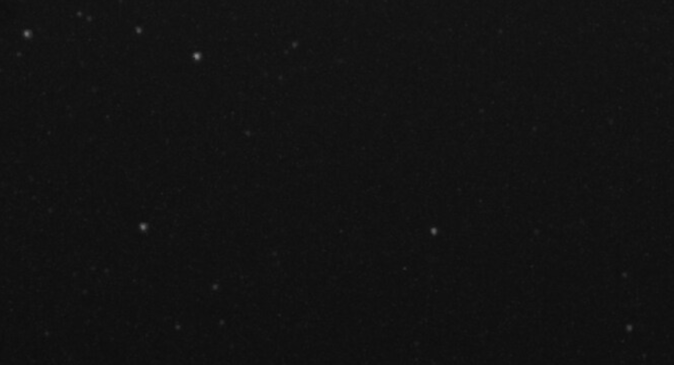

                      We use F0.95 lenses on our cameras and remove the IR-cut filter to capture more starlight. The downside is that we can only achieve perfect focus for either visible or infrared light, though sharp focus is still possible for each individually. In our setup, we compromise by focusing somewhere in between.
                      We see this exact behavior on our IMX462, IMX462 mono (VEYE), and IMX662 mono (another vendor ) sensors. However, on the color IMX662 sensor, I am unable to get a sharp focus at all. It feels as if the visible light and infrared light from the star interfere with each other simultaneously, making the image constantly blurry.
                      I thought I could at least use this camera with an IR-cut filter, but for some reason, the stars became extremely dim. I am not sure if this is a software issue, or if the color Starvis 2 sensor simply handles light differently.
                      See the sample photos below (please note - it is stack of 8 seconds) :
                      imx662 without IR filter and no focus
                      imx662 with IR filter and stars extremely dim
                      and my imx662 mono sensor, without IR filter
