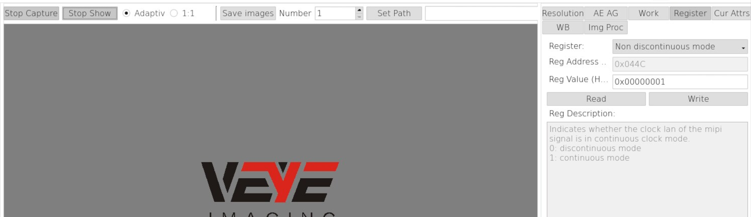

                  I installed new driver and no differences - no video for value 1
                  My PiOs : 6.18.39+rpt-rpi-2712
                  dmesg log:
                  [    2.624024] gxcam 10-003b: veye gx series camera driver version: 01.00.04
                  [    2.624247] gxcam 10-003b: no reset gpio provided
                  [    2.685103] gxcam 10-003b: camera is: GXC-MIPI-IMX662
                  [    2.688265] gxcam 10-003b: VideoModeCap: 0x2
                  [    2.706466] gxcam 10-003b: gxcam_enum_controls success
                  example of veye_viewer and no video
                    veye_xumm @alex_ai
                    @alex_ai
                    Register 0x44c should indeed be configured to 1.
                    This is quite strange, as the image preview works perfectly on our end with the exact same configuration.
                    1. Are you viewing the image via remote desktop?
                    2. Under the same conditions, does setting register 0x44c to 0 produce an image (with jitter), while setting it to 1 results in no image at all?
                    A 1 Reply Last reply Reply Quote 0

                      alex_ai @veye_xumm
                      yes, also just tried with hdmi - same
                      yes, it works if set 0 with jitter and no image with value 1, I recorded video to demo

                        alex_ai @alex_ai
                        Just tried to run it on Rpi4 (bookworm 6.12)
                        It is same: no image for setting 1 but for 0 - no jitter!
                        Probably this issue only for Rpi5 (trixie 6.18).
                        Not sure how it works for you with value 1, I tested on 2 devices and it same no image for value 1
