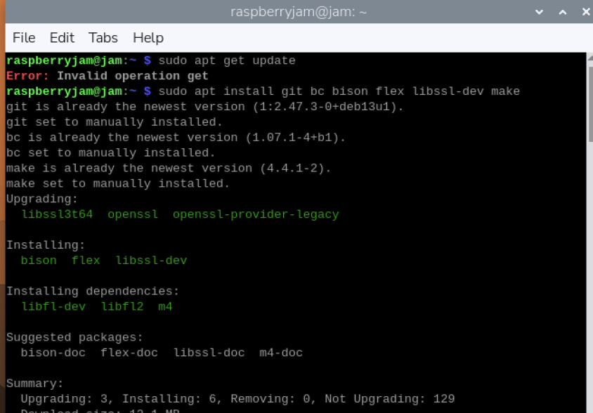

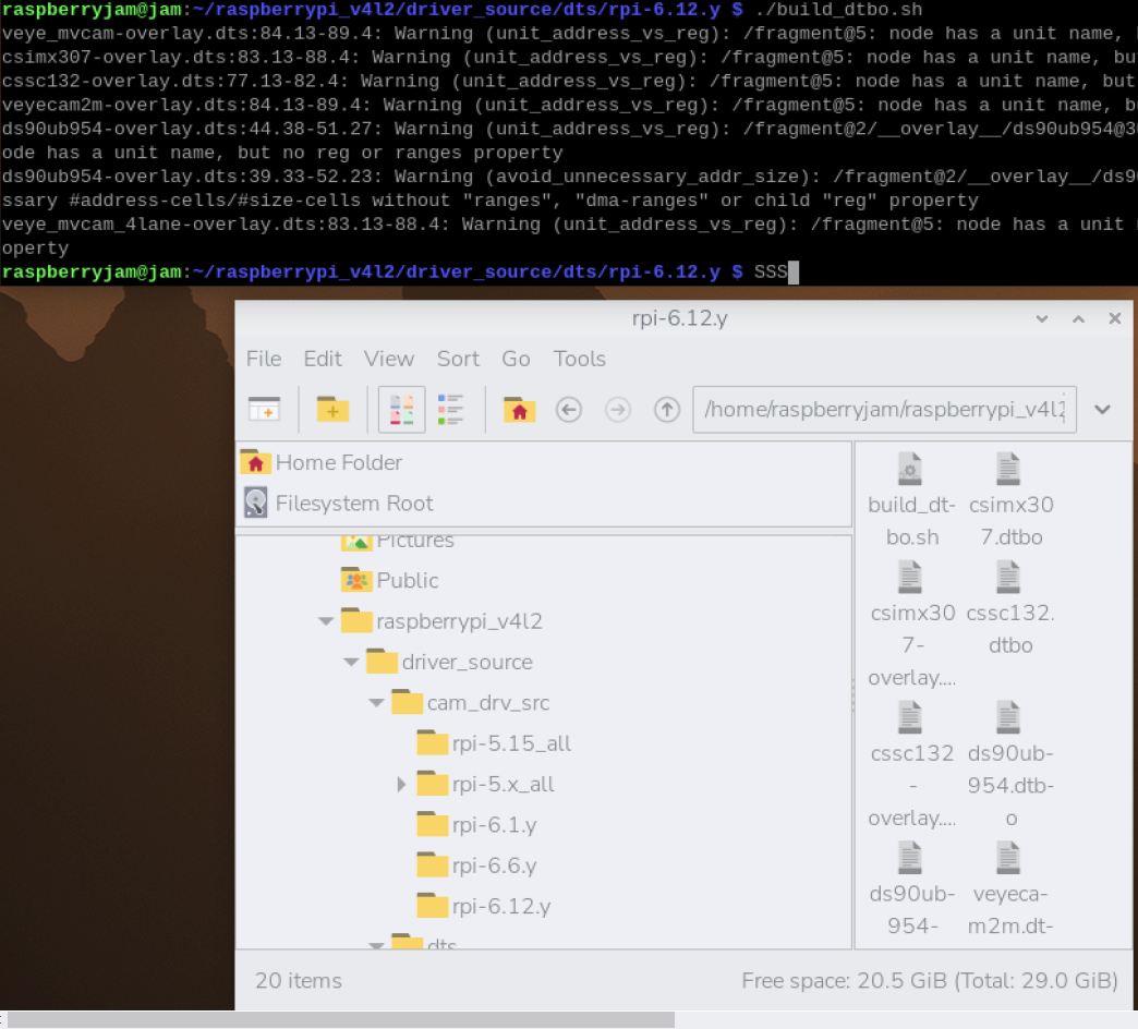

      Followed this, when compiling dtb the error pops up
      ![alt text](c07f9324-c61b-4227-80f0-d2da4621d91e-изображение.png image url)
      Trying to install headers didn't work, manually copied and created the directories, still an error

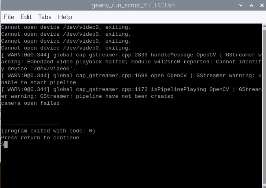

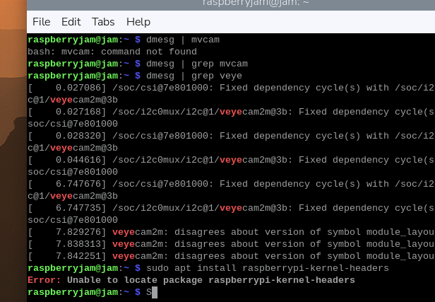

      dmesg doesn't work (doesn't say anything. Camera worked before with Legacy mode.
      ![alt text](bada1a01-c29c-4829-98d0-7bbd0cc2e727-изображение.png image url)
      do I need to recompile on ubuntu? I don't have one installed, don't have spare pc or laptop.
      I want to use it with opencv and yolov3tiny for bug detection.
        veye_xumm @jambojettt
        @jambojettt According to the dmesg information, you have successfully installed the veyecam2m driver. However, the camera was not detected. What model of camera are you using?

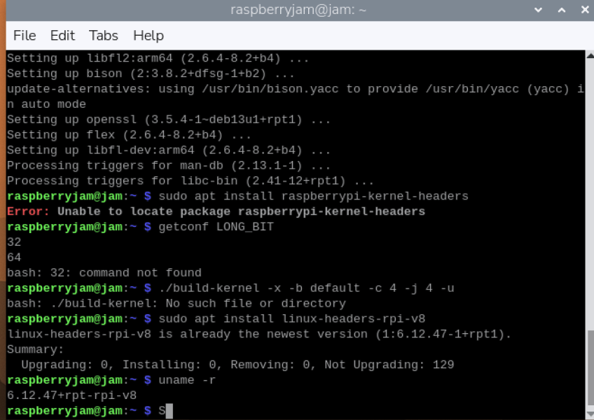

            Normally, after you install the kernel headers using the command sudo apt install raspberrypi-kernel-headers, you should be able to compile successfully.
            May I ask — after performing this step, what error do you see during compilation?
            J 1 Reply Last reply Reply Quote 0
            • J Offline
              jambojettt @veye_xumm
              @veye_xumm this didn't work, I updated the raspi-config to the latest one, this command didn't work. Tried this several times to no avail.

                      @veye_xumm yes, it updated to 6.12.57, but this problem also was in 6.12.47 that it was updated from.
                      How do I get the headers?

                          @veye_xumm I tried it before. Right now reinstalled Pi OS from Pi Imager, no kernel headers, so problem not resolved.

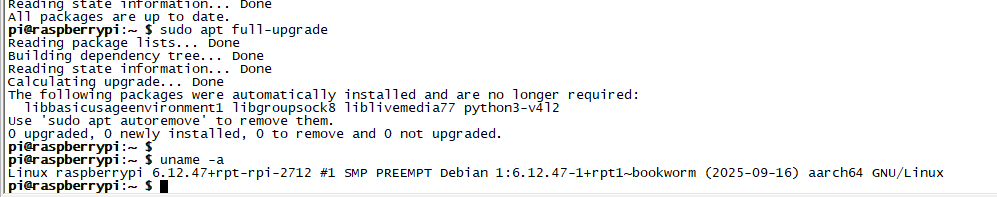

                          • J Offline
                            jambojettt @jambojettt
                            @jambojettt Just checked, I have a 64 bit version, just to be sure.8df17cf4-ca53-47b8-9727-a8736dd077dc-изображение.png d9607aad-14c0-4f65-bfdc-0c86dedff947-изображение.png
                            Kernel headers are installed.

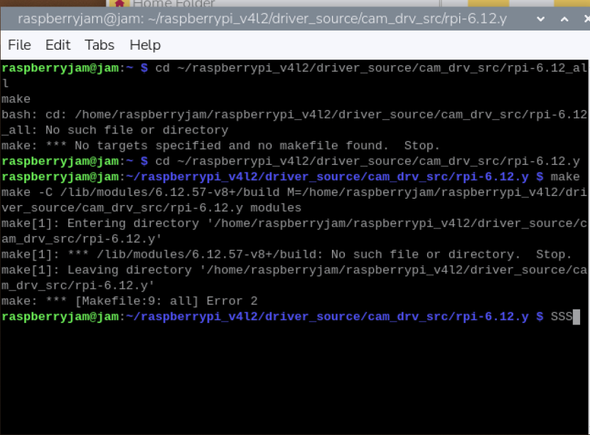

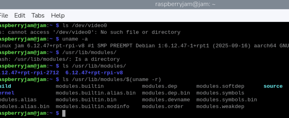

                              Did everything step by step on the github page. The kernel thing didn't work. Don't know what to do next. dmesg didn't work

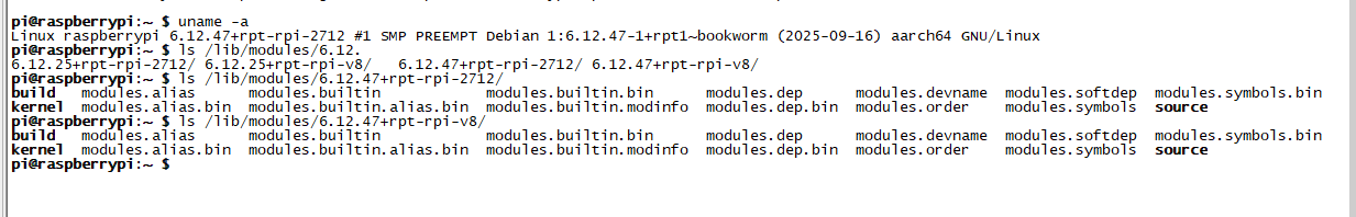

                                @jambojettt
                                Normally, the PiOS you installed comes with kernel-headers. Could you tell me which image link you used?
                                Can you help run this script and send me the results?
                                uname -a
                                ls /usr/lib/modules/
                                ls /usr/lib/modules/$(uname -r)
                                • J Offline
                                  Wrote them, sending the results.

                                    @jambojettt
                                    Sorry for reply late.
                                    I see that your raspberrypi-kernel-headers are installed. You should be able to directly run make in the driver source code directory.

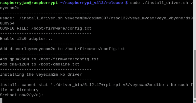

                                        Please try this released version again. This time it will work.
                                        https://github.com/veyeimaging/raspberrypi_v4l2/releases/tag/v1.27
                                        • J Offline

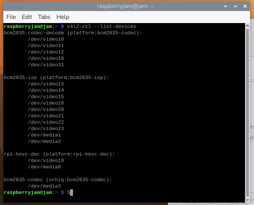

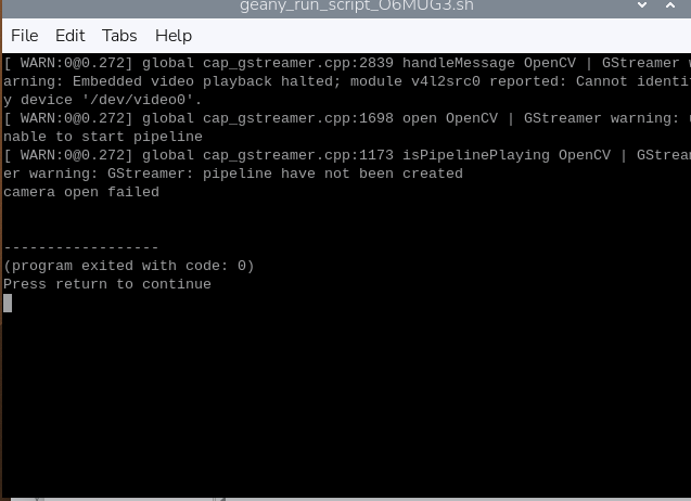

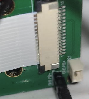

                                          @veye_xumm did delete a folder raspberrypi_v4l2, reinstalled. Checked the connections, everything was in order. Pins on the ribbon cable to the top on the module and to the front on the pi. Checked the power pins. Everything was okay. I don't have samba in raspi-config, but I enabled ssh. Also don't have Camera interface in options.
                                          The dev/video0/ is still unfound.

                                            show me the result of this cmd:
                                            dmesg | grep veye
